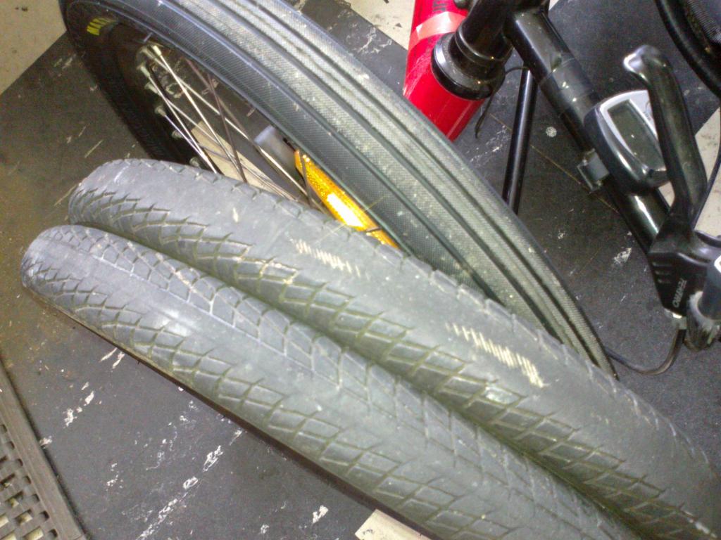

    I weighed, multiple times using a digital scale, each wheel with me sitting in the seat as if I was riding the trike. The scale will not measure just the trike. I put blocks under the wheels not being weighed so that the wheels were equally off the floor.
    Rear wheel = 32.79%
    Left wheel = 29.49%
    Right wheel = 37.72%
    Based on the above percentages the right tire should be the one wearing the fastest. The right tire is the front tire in the photo above.

    Subtracting my weight from total weight (weighed at the same time as the trike) the trike weighs 79.2 pounds. That means there is 37.9 pounds of stuff (rear rack, side seat bar (right side of seat), bag and stuff on side seat bar, tool bag with tools and parts behind the seat, rear fender, lights, water bottle cages, computer, pedals, etc) on the trike. I guess it adds up quickly.

    The trike
    • weighs 41.3 pounds (per website) without anything added to it including the pedals.
    • has a weight limit of 375 lbs (per website).
    The numbers I got with me on the trike added up to almost 300 pounds. I doubt the numbers I got with the digital scale are 100% accurate. I say that because I really don't have a problem lifting the trike to get into my truck or onto the work bench. If it weighs 79+ pounds I don't really think I could do that. I need to find a place where I can weight the trike (all 3 wheels at one time) so I can get the real weight.
    On another forum, readers have made comments that they are surprised that I got the amount of miles I did out of Big Apples. Some have said that 1000 – 1200 miles is the very max for BA's.
    Schwable's response to my email was “Being the rear it will have more weight on it causing it to wear faster than the front.” It appears that they totally missed my first sentence were I stated that the tire is on a trike and are thinking only about a 2 wheel bike. My numbers show that only 33% of the weight is on the rear, assuming that the percents are correct, even though I don't believe the total weight that I got.
    Here is a comparison of the rear tires on our two trikes. My wife has about 700 miles less miles on hers. The wear rate appears to be the same, no scientific way to measure it, for me at least.
    I'm willing to give up some of the “smoothness” of the ride that the BA gives for a tire that will give me more miles. I have a DF (original tires) that has the same miles on it as the trike does, and the only reason I'm about to change them is because of the sidewall rot, not because of the tread being wore out. A DF puts 55 – 70% of the weight on the rear based on frame design. If I don't wear out the rear tire on the the DF with more weight on the rear then the rear on the trike, why are the rear tires wearing out on the trikes? Short answer – the BA's are not a long-lasting tire.
    I am seriously thinking about moving the rear tire to the front on both trikes to postpone the expense of new tires.

    I have been trying the Maxxis tyres and been getting good wear from them. I must say that we have very good surfaces which I ride upon - really no rough surfaces at all.
    My rear 26 inch Maxxis did wear out first [ Of course I rode till there was Kevlar belts showing all around it :) ] think that was at about 6000 km [ 3728 mi ]....
    The front Maxxis The Miracle lasted approx 9000 km [ 5592 mi ] .
    I grabbed some old BMX tyres from a kids bike, Thinking they would last at least 1000 km [ 621 mi ] ...........
    Here is pic after just 200 km [ 124 mi ] , see new Maxxis installed :)

    if this were an automobile rear tire, obvious case of over-inflation.
    put a new tire on, run it at 35 psi, and let us know?
    simple enough to check weight distribution on the trike - put a bathroom scale under each wheel in turn. close enough values without using 3 of the same scale to maintain level stance.

    The photo mentioned in the last quote is in post #4 of this thread.
    I rotated the front right with the rear. I have only put 350 mile on the trike since then, so it is too soon to see how long the new use rear is going to last.
