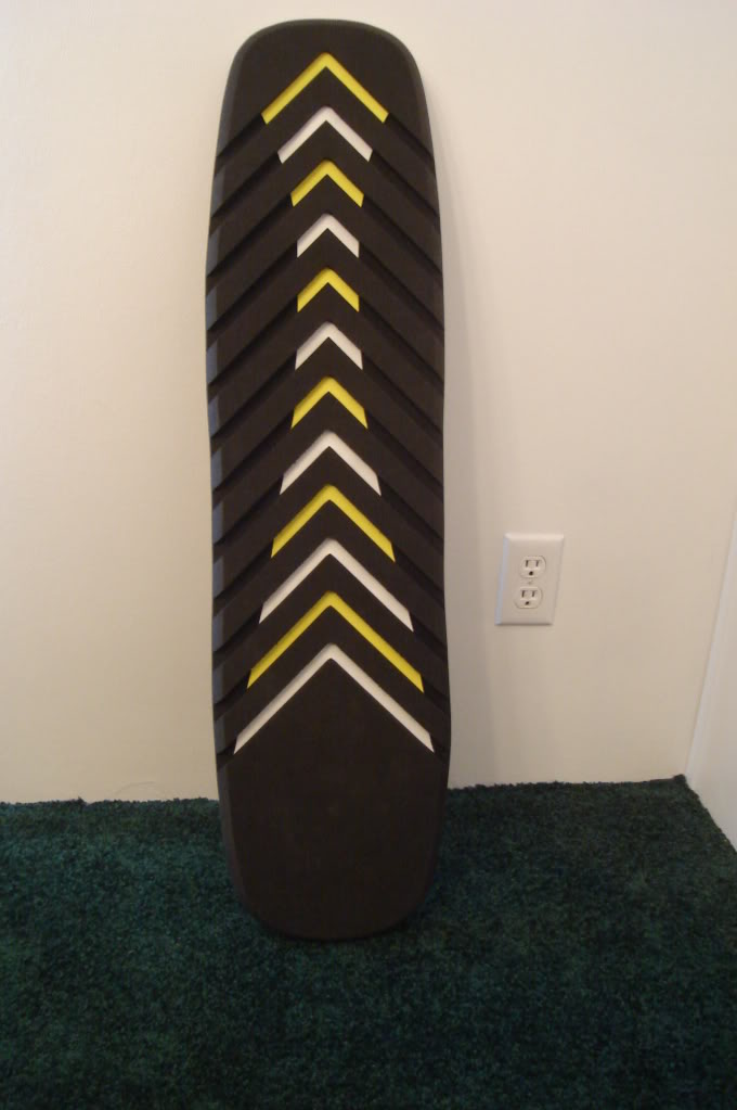

    I don't know for sure, but if it's a shell-type seat, then there's a good chance that Don Smith (airxxxwolf) could make you a zotefoam pad. He's made these for many, many 'bent riders over on bentrideronline. I've got several of the thinner models on my bents. Zotefoam is firm - it doesn't compress much at all - but has just enough give to keep you from being bruised. Here's one he made for a Fujin:
    The pad shown is 3/4" thick, with 1/2" deep grooves. The color strips can be customized and/or replaced.
    Don can be contacted at bbmracing*yahoo.com

    How does the pad attach to the seat body?
  7. BlazingPedals
    BlazingPedals
    Haslett
    M5CHR
    Velcro, loops glued to seat and hooks glued to the back of the pad. IIRC, the velcro and glue is included.
