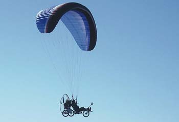

    SILHOUETTED against a brilliant blue sky, Andrew Polidano conjures up memories of E.T. as he powers along in his flying bike, the so-called flyke.
    The Flyke, according to Mr Polidano and his neighbour and fellow flyer Eddie Gray, is set to be the new aerial craze.
    A paragliding instructor, Mr Polidano was the first person in Australia to own one, importing from the German inventor in 2002 and quickly assembling the contraption.
    The flyke is a recumbent, pedal-powered, 14-speed trike, with a two-stroke paramotor engine that drives a 1.2m-diameter propeller attached to a paragliding wing.
    Mr Gray took to the air for the first time in 2006 and, last year, the pair flew an incredible 1000km from their home town of Mullumbimby in northern New South Wales to Wagga Wagga to raise funds for the Cancer Council.
    source couriermail.com.au

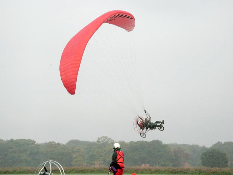

    For my first flight, Chris Bowles and I took the Flyke over to his PPG field. We filled the tank with fuel, laid the wing out behind the Flyke and clipped the risers to the attachment points. Chris had me set the steering mechanism to its tightest setting, and we clipped the launch assist lines into the quick links of the glider’s A risers. After making sure the Flyke was centered in front of the wing, and the wing centered in the wind, I was ready to fly.[/FONT]
    [FONT=Arial, Arial, Helvetica] A quick pull of the started and the Monster roared to life. Strapped in, put the brakes and throttle in my hands and got a thumbs up sign from Chris. I was ready to go flying. With the power of the Monster, the wing inflates quickly, so quickly that you need to let up on the power slightly as it moves overhead. With the Flyke steering itself, my only concern was flying the wing. Once the wing was overhead, it was back to full throttle and in 10 feet I was off the ground.[/FONT]
    [FONT=Arial, Arial, Helvetica] [/FONT][FONT=Arial, Arial, Helvetica]
    I cannot begin to describe how much fun the Flyke is to fly. I quickly climbed to 500 feet and started some gentle turns that soon turned into a crank-n-bank session. The Monster provided more than enough power to hold altitude, even during the sharpest turn. With Silex above and a Monster behind, the Flyke has the perfect combination of speed, agility, and power that motorheads crave for precision flying.[/FONT]

  3. Mtwnrocket
    "Like most recumbent bikes, it has front wheel drive and has 7 different gear settings."
    Hmmm... never saw a front wheel drive 'bent except for a handcycle.
    Also, the hot-dogger flying the thing 15 feet off the ground has no helmet. Plus the text says there's no harness and the "cage" around the pilot offers minimal to no protection. The trike is a delta configuration vs. Tadpole, like regular ULs. Given a choice, I would think landing a tadpole would be easier.
    Anyway, sounds to me like a death trap.
    I'm a bit sensitive about this type of vehicle. A fixed-wing ultralight pilot was killed two Sundays ago at Cooper Field near Buddy and Mickey's homes, and only a couple of hours before I arrived at the field.
