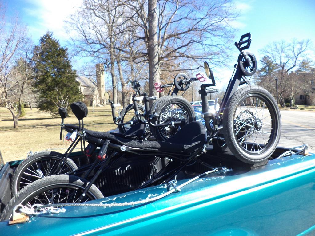

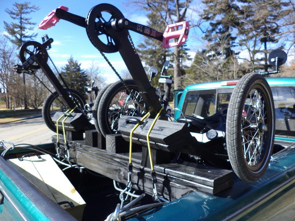

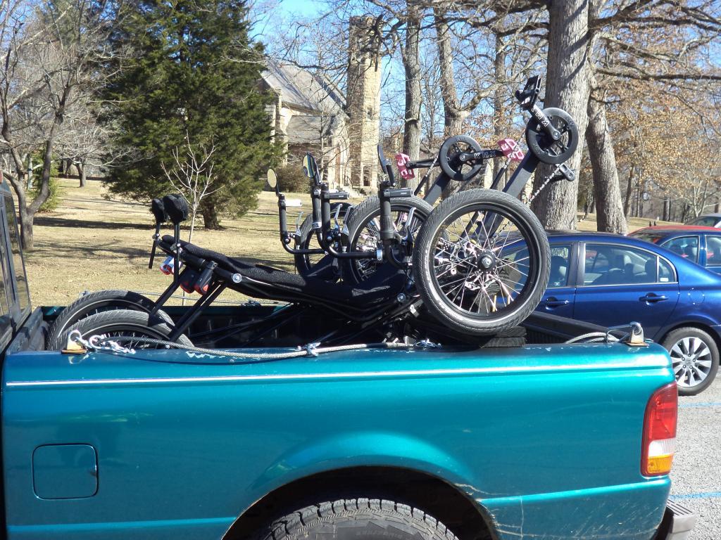

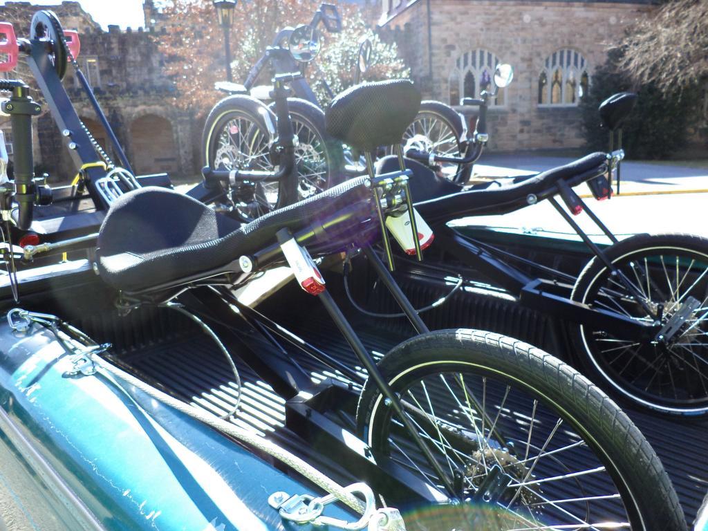

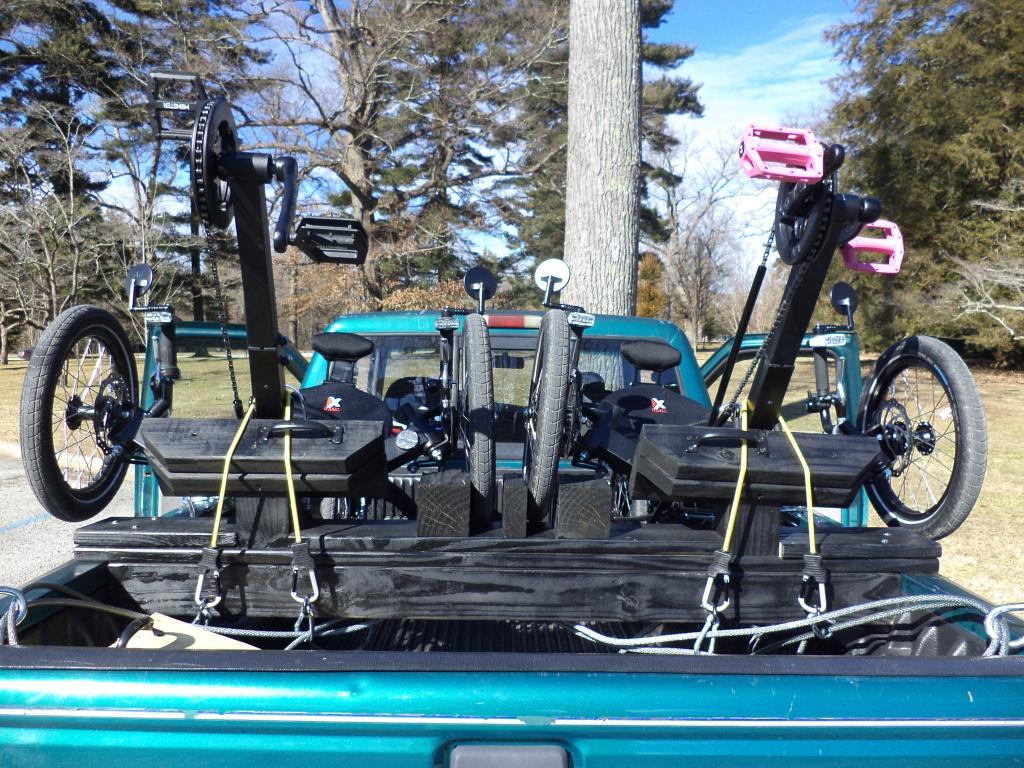

    Using some left over Deck Material (4x4s, 2x4s, Deck Planks), I made a Hauler for Our two KMX Typhoon 8 Trikes. My Short Bed $525 (I run a Truck Used Salvage Yard...:tongue9:)'95 Ranger Pickup is too short to haul one without the tailgate down, and not wide enough for two. This necessitated some "Redneck Ingenuity" to be used, so this is what I came up with. It actually works well. The KMX Frames fit snugly between eyelets coated with rubber fuel hose and can't move around, even without being bunged down. The Front Wheels fit into guides, and the cables You see can be used to lock everything to the Truck by running Them through the wheels, and over the Frames in case we go in somewhere and They're left unattended for a short while......
    Loading and Unloading is fairly simple, and I have a homemade step I carry also to help my 5'7" Frame load 'em if necessary.......Having a Lota' FUN with the Trikes.....skuuter...:thumbsup:
