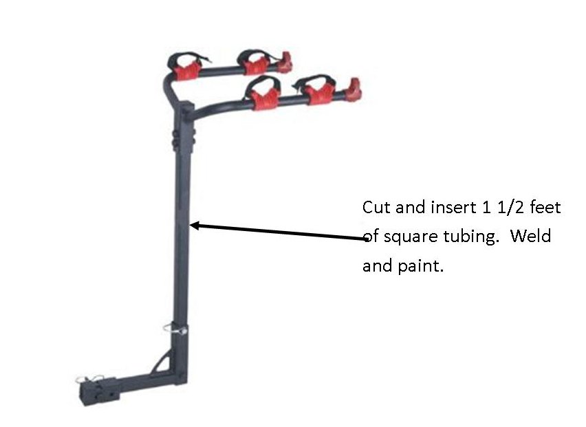

    When I had my trike, I bought a standard bike rack. 2 inch square metal came off the receiver, then went up and attached to the bicycle brackets. (This was left over from when I was riding a road bike.) So I took it to a welding shop, they cut the vertical piece from the receiver to the bike backets and added 15 inches. That made it tall enough to mount the top of the trikes front wheels over the bicycle rack arms and the third wheel was bungle corded to the bottom of the vertical poll.
    Trike was easy to put on and take off and rode very securely. The top two legs were held by the rubber straps made to hold the bicycle frame and the bottom wheel with the bungie cord. Took 1 minute to put on or take off and did move an inch while I drove it from Knoxville to Florida on spring break vacations.

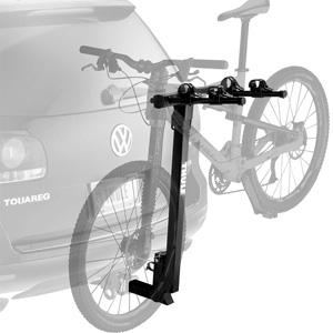

    Sorry, no pictures of that set up. I think I had a 2 inch square Thule bike rack set up for 4 bikes. The welding shop did a great job and you had to look hard to see the insert.
    The hitch looked something like this.
    The vertical piece gets cut and you add an additional 12 - 18 inches depending on you size of your car and trike.

    my .02$ As a fabricator in another life I really like the idea of lengthening the existing rack but I would add that you are stressing the design of the original. Not a show stopper but I would recommend adding a gussett to the 90 degree angle just to be safe. You should also frequently inspect the welds for stress cracks. Anything that looks like a crack in the paint is probably suspicious for a crack in the weld.
    Jerry
